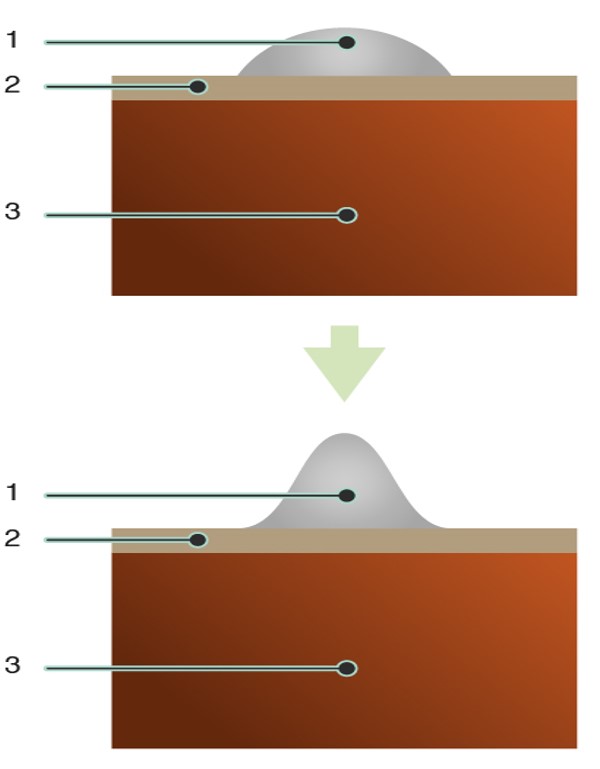

A typical silicon solar cell production process requires multiple screen printing runs, and there are at least two separate printing steps for the front and back sides of the cell. For improved efficiency, contact lines on the front side must be printed as finely as possible without reducing conductivity, which requires the printing of layers that are overlaid with high accuracy and repeatability.
By making the lines thinner and taller, more of the cell can participate in solar energy conversion (Figure 4). For instance, moving from contact fingers with 120 µm line width to 70 µm line width, with twice the thickness, gives a potential conversion efficiency gain of 0.5 %. Another technique for improving performance is the use of selective emitters - the n-doped front side of the solar cell. By strongly doping the area directly below the metal contacts and only weakly doping the other areas, cell efficiency at shorter wavelengths can be improved (Figure 5).
There are several techniques available for manufacturing selective emitters and most involve the highly-accurate alignment and deposition of layers. Screen alignment accuracy is the most critical metric for multi-layer printed contacts because subsequent print layers must be precisely placed over the first. State-of-the-art alignment systems with high-resolution cameras are now capable of ±10 µm alignment accuracy. High-precision position encoders, such as Renishaw's RESOLUTE absolute encoder system, are key to improving print screen overlay accuracy and control. RESOLUTE encoders are capable of high translational speeds to 100 m/s, high resolutions to 1 nm, and low cyclic error of ±40 nm.
Fig 4: reduction of the line width of metal contact fingers increases solar cell efficiency
(1 - Metal contact, 2 - Doped margin, 3 - Substrate)
