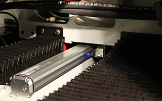

FORTiS™ enclosed encoder inside TGT's tool grinding machineFORTiS™ enclosed encoder inside TGT's tool grinding machine

In 2021, TGT launched the V2 ADVANCED Maxima - a five-axis high precision tool grinding machine comprising three linear axes (X, Y and Z) and two rotary axes (A and C).
Tubular linear motors are employed on the crosswise X-axis and the longitudinal Z-axis of this machine with strokes of 300 mm and 680 mm, respectively. Both axes are equipped with the FORTiS-S™ enclosed encoder system, which is the standard-sized variant of the FORTiS encoder.
The vertical Y-axis is equipped with a ball screw system as standard, but customers can also choose a linear motor-driven axis with a FORTiS-S encoder if required. The rotary A-axis is mounted on the rotary C-axis and both axes control the orientation of the workpiece using direct drive motors, equipped with the RESOLUTE absolute rotary encoder, to reduce backlash.
Both the RESOLUTE and FORTiS-S encoders output BISS-C serial comms for direct interface with a Beckhoff controller. During processing, the A-axis rotates the workpiece, which is clamped on the workpiece spindle, while the linear axes (X, Y and Z) control the position of the grinding wheel.
This tool grinder is also equipped with Renishaw's LP2 series probe system for workpiece set-up prior to grinding. In the early stages of product development, TGT tested a range of FORTiS-S enclosed absolute encoders with resolutions from 10 nm down to 1 nm. To achieve the best overall machine performance, TGT selected the FORTiS-S encoder with a resolution of 1 nm.
