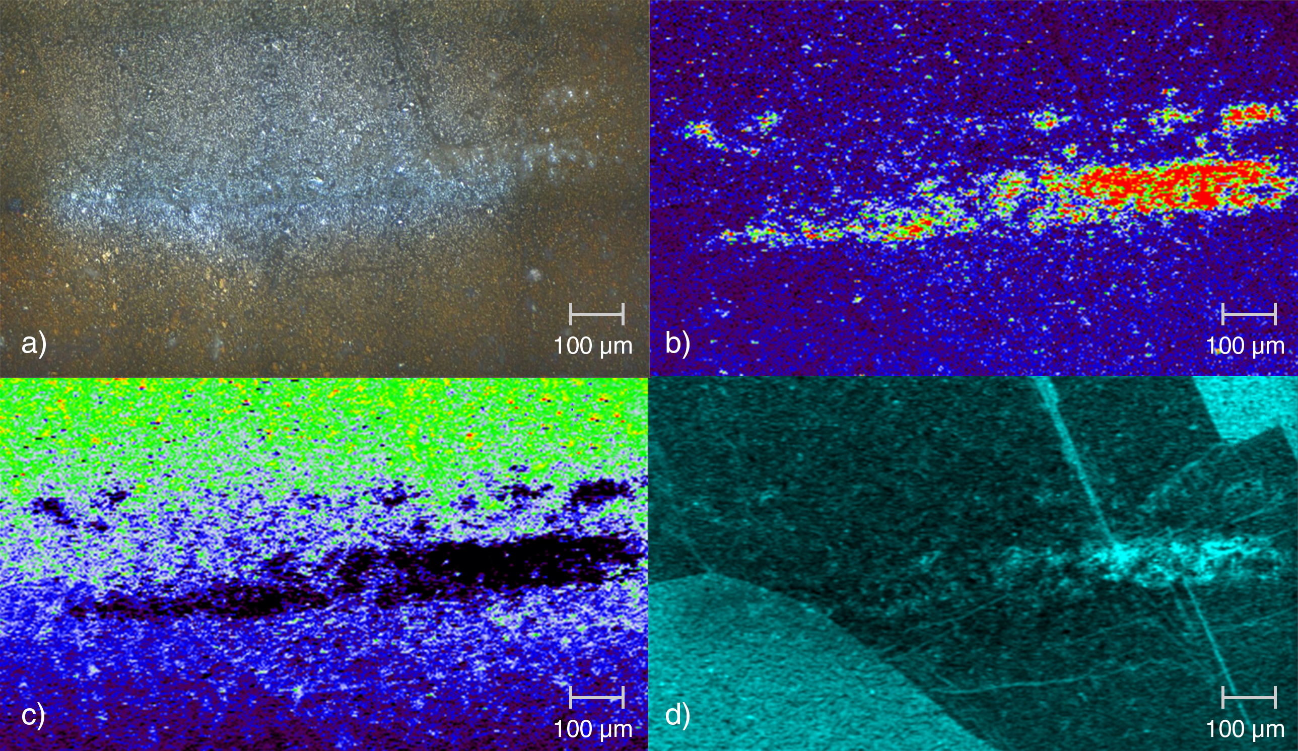

  • Discoloured polycrystalline solar cell Discoloured polycrystalline solar cell

Raman images are a vital tool in photovoltaic development as they can reveal how material properties vary across devices.
With Renishaw's StreamLine™ and Slalom technologies, you have all the flexibility you need. Analyse both small and large areas, at whatever resolution you require. This provides better knowledge of the device as a whole, not just a small part of it.
