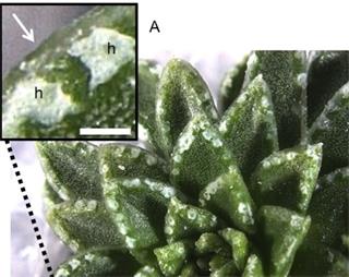

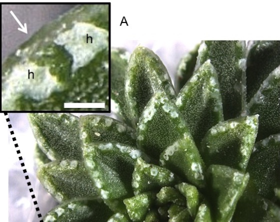

The Garden has a national collection of European Saxifraga plant species. Vaterite was found to be a dominant component of the protective silvery-white crust that forms on the leaves of a number of alpine plants. Dr Wightman said: “In this case, the inVia microscope not only identified signatures corresponding to calcium carbonate as forming the crust, but was also able to differentiate between the calcite and vaterite forms when it was present as a mixture while still attached to the leaf surface.”
This discovery is all the more exciting because naturally occurring vaterite is rarely found on Earth. This is the first time that it has been found in such a large quantity and the first time it has been found to be associated with plants.
