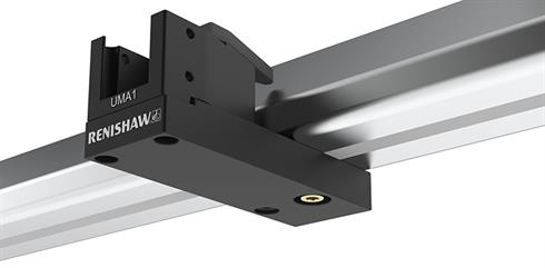

Attaching the UMA1 assembly to the rail
1. Insert the D-nut into the grove on the underside of the MRS2 rail by rolling into place.
2. Align the UMA1 assembly and the screw with the threaded hole in the D-nut.
Attaching the UMA1 assembly onto MRS2 rail
3. Screw in to place and tighten fully.
