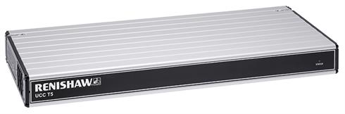

UCC T5 universal CMM controller
CMM controller for 5-axis touch-trigger motion and head control - PH20 only
Must be used in conjunction with a Renishaw SPA3 amplifier- Uses an external power supply and manages full control of the PH20 head, CMM and probe signals and communicates with the CMM's computer
- Replaces the UCC2-2 and 5-axis daughtercard for PH20 installations
- Has integral thermal error compensation (TEC) with support for 16 channels of temperature compensation
- Setup and commissioning should be completed through Renishaw's UCCassist-2 software
