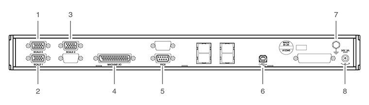

  • Rear panel connectors for the external interface cables to and from the CMM
  • Rear panel USB connection for the two-way communication link to the CMM host computer
UCC MMI-2 front panel
UCC MMI-2 rear panel - labelled
Key Description Key Description
1
Scale 0 interface (15W HDD socket)5PICS (9W D socket)
2
Scale 1 interface (15W HDD socket)6PC connection (USB type B)
3
Scale 2 interface (15W HDD socket)7Earth terminal
4Machine I/O (44W HDD socket)8UCC MMI-2 power jack (6.3 mm socket)

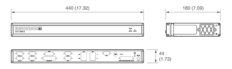

Dimensions
Width
Height
Depth
440 mm (19 in enclosure)
44 mm (1U)
180 mm
UCC MMI-2 dimensions
NOTE: Dimensions in mm (in).
