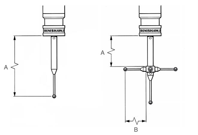

Unidirectional repeatability (2σ μm)
Stylus type  | Offset length A (mm)  | Offset length B (mm)  | Trigger level 1 (µm)  | Trigger level 2 (µm)  |
Straight  | 10  | -  | 0.2  | 0.25  |
Straight  | 50  | -  | 0.4  | 0.5  |
Straight  | 70  | -  | 0.7  | 1  |
Straight  | 100  | -  | 1  | 1.2  |
Star  | 5  | 20  | 0.5  | 0.7  |
Star  | 50  | 20  | 0.7  | 1  |
