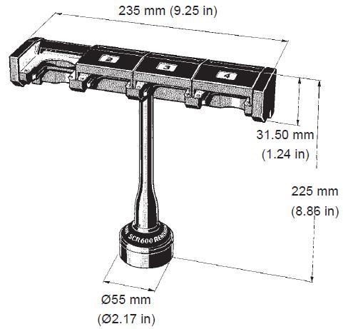

SCR600 stylus change rack
Passive stylus change rack for use with SP600
No electrical connections required- Overtravel protection in the probe entry direction by a mechanism in the base which can be manually reset
- Holds up to four SH600 stylus holders per rack
- Any number of racks can be used in a system
Dimensions
NOTE: Dimensions in mm (in).
Part number | |
SCR600 stylus change rack for use with SP600M and SP600Q | A-2098-0255 |
SCP600 stylus change port to be mounted on MRS / MRS2 for use with SP600M and SP600Q | A-2098-0933 |
