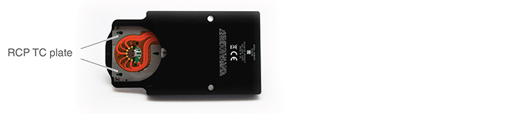

RCP TC-2 and RCP TC-3 LED status indication and troubleshooting
LED | Status | Troubleshooting |
Green | Power on, probe present, temperature within target | n/a |
Flashing green | Power on, probe present, temperature outside of target | Wait for the rack to reach stable temperature. |
Amber | Power on, probe not present, temperature within target | If the probe is present, clean the port and probe contacts. |
Flashing amber | Power on, probe not present, temperature outside of target | If the probe is present, clean the port and probe contacts. Wait for the rack to reach stable temperature. |
Flashing red | Error | Cycle power to restart. If the problem persists, contact your supplier. |
WARNING: The RCP TC-2 or RCP TC-3 plate may be hot.
