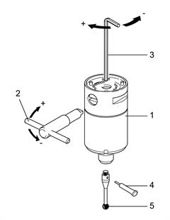

TP6A touch-trigger probe
The TP6A touch-trigger probe has all the features of the TP6 with the added benefit of the Renishaw autojoint. This is a highly repeatable kinematic joint which allows rapid probe exchange without the need to requalify the probe tip. It can be operated either manually, using an S10 autojoint key, or automatically, using the autochange rack system.
This probe can be used successfully on both universal DCC and manual CMMs. It incorporates an M3 stylus mount which offers compatibility with all Renishaw's extensive M3 and M2 stylus and accessory range.
1
TP6A probe
2
S10 autojoint key
3
1.5 mm AF Allen key to adjust trigger force
4
S7 stylus tightening tool
5
Stylus (not supplied)
