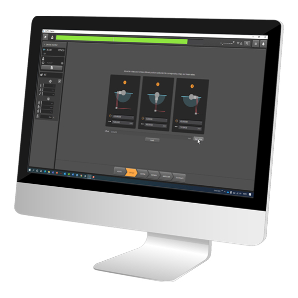

Off-axis rotary measurement mode Product code: CS-SOF-SW-03-OAR Off-axis rotary measurement mode in CaptureNo description available[0B] Off-axis rotary measurement mode in Capture No description available [0B] CARTO capture off-axis rotary measurement mode No description available [0B] Price: $1,700.00 All prices are ex sales tax Add to new group Before you begin to add items to your favourites please create your first group: A favourites group name can only be 1-80 alphanumeric characters and must not begin with white space Product sucessfully added to View favourites Processing request The Off-axis rotary measurement mode in CARTO, provides a single source for testing off-axis measurement using the XR20 rotary axis calibrator and XL-80 laser system or XM-60 multi-axis calibrator. Off-axis rotary measurement mode allows the user to: automatically calculate the offset distance between the centre of rotation of the XR20 rotary axis calibrator and the centre of rotation of the rotary axis generate a test part program (which synchronises rotary axis and linear axis moves to maintain laser beam alignment) remove any contributory linear axis angular error from the observed rotary axis results, giving 'clean' results for the rotary axis Off-axis rotary measurement mode is supplied as an activation ID compatible with Windows 10 64-bit (version 1803 or greater). Shopping security Recall your cart
