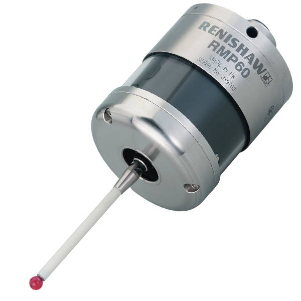

RMP60 QE probe kit including batteries and tool kit.
The RMP60 QE is a compact spindle probe with radio signal transmission.
Ideally suited for workpiece inspection and job set-up on multi-tasking machines, machining centres and gantry machining centres, including 5-axis machines.
The RMP60 QE probe is compatible with RMI-QE and RMI-Q interfaces. It is not compatible with the RMI interface.
Probe switch-on / switch-off methods are user configurable. The factory-default setting of radio on / radio off can be modified to radio on / timer off (timeout), spin on / spin off, spin on / timer off (timeout), or shank switch on / shank switch off if required.
Technical table
Transmission typeRadio
Key features and benefits:
• Proven kinematic design
• Secure frequency hopping spread spectrum (FHSS)
• Globally recognised 2.4 GHz waveband compliant with radio regulations in all major markets
• Ultra-compact design
• Increased environmental protection
• 1.00 µm 2σ repeatability
• Provides an increase of up to 400% in battery life compared with previous generation probes
