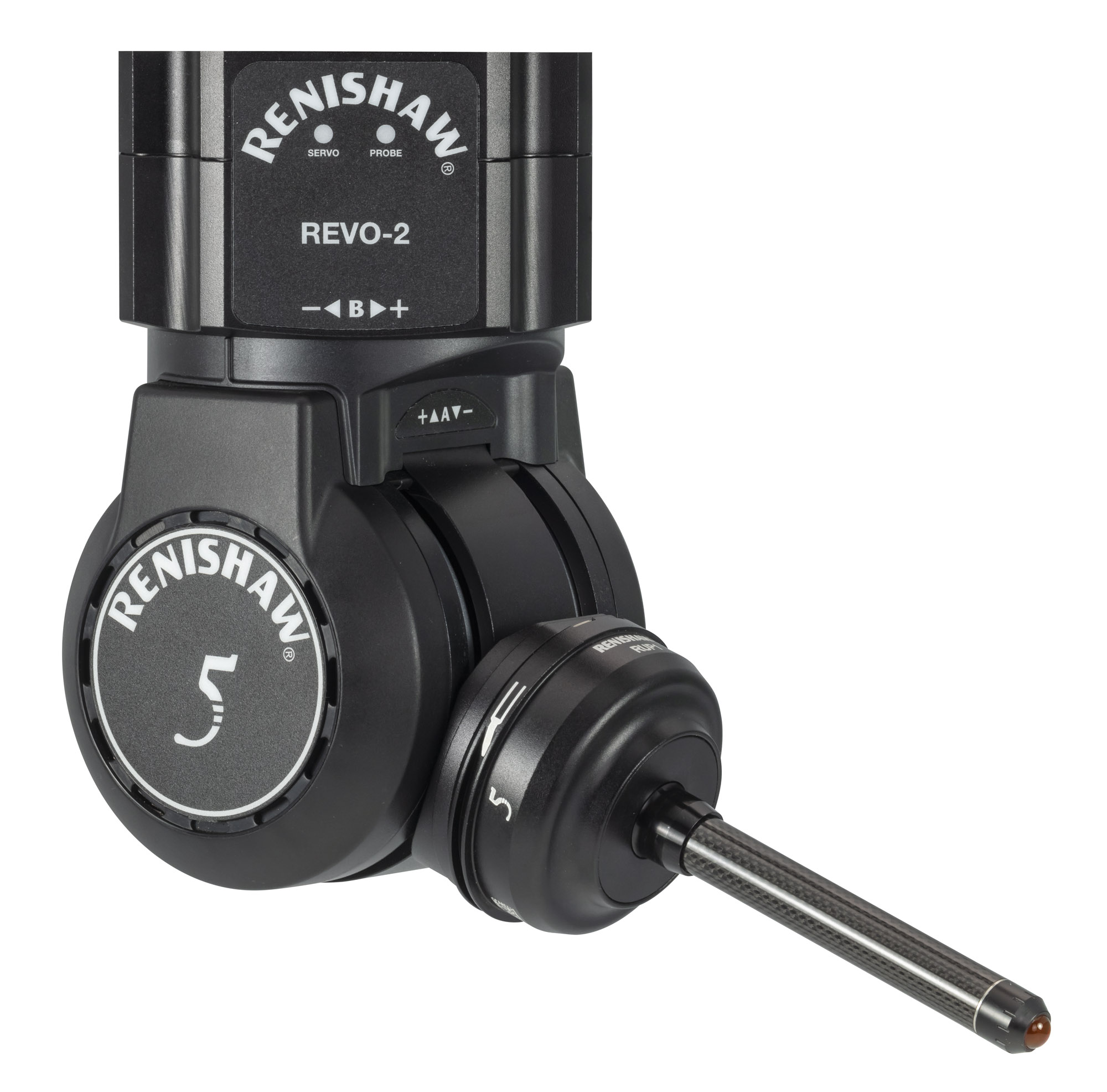

The REVO® 5-axis multi-sensor system will be on show with its extensive range of probes. The 5 axis CMM measurement system offers automatic switching between tactile scanning, touch-trigger, ultrasonic, vision, and surface finish measurement.

The REVO system's RSP2 tactile scanning probe leverages the 5-axis motion to inspect complex geometries rapidly and accurately. It is particularly effective in scanning planes, cylinders, and valve seats and guides on an engine head. Traditional methods often involve slower, point-by-point data collection, but with RSP2, dense data sets are gathered quickly, leading to more efficient inspection processes. Additionally, the RSP2 probe's ability to sweep scan the hairpin heights on the top of an EV stator and report the highest point of these pins provides valuable data for quality control and process optimization.

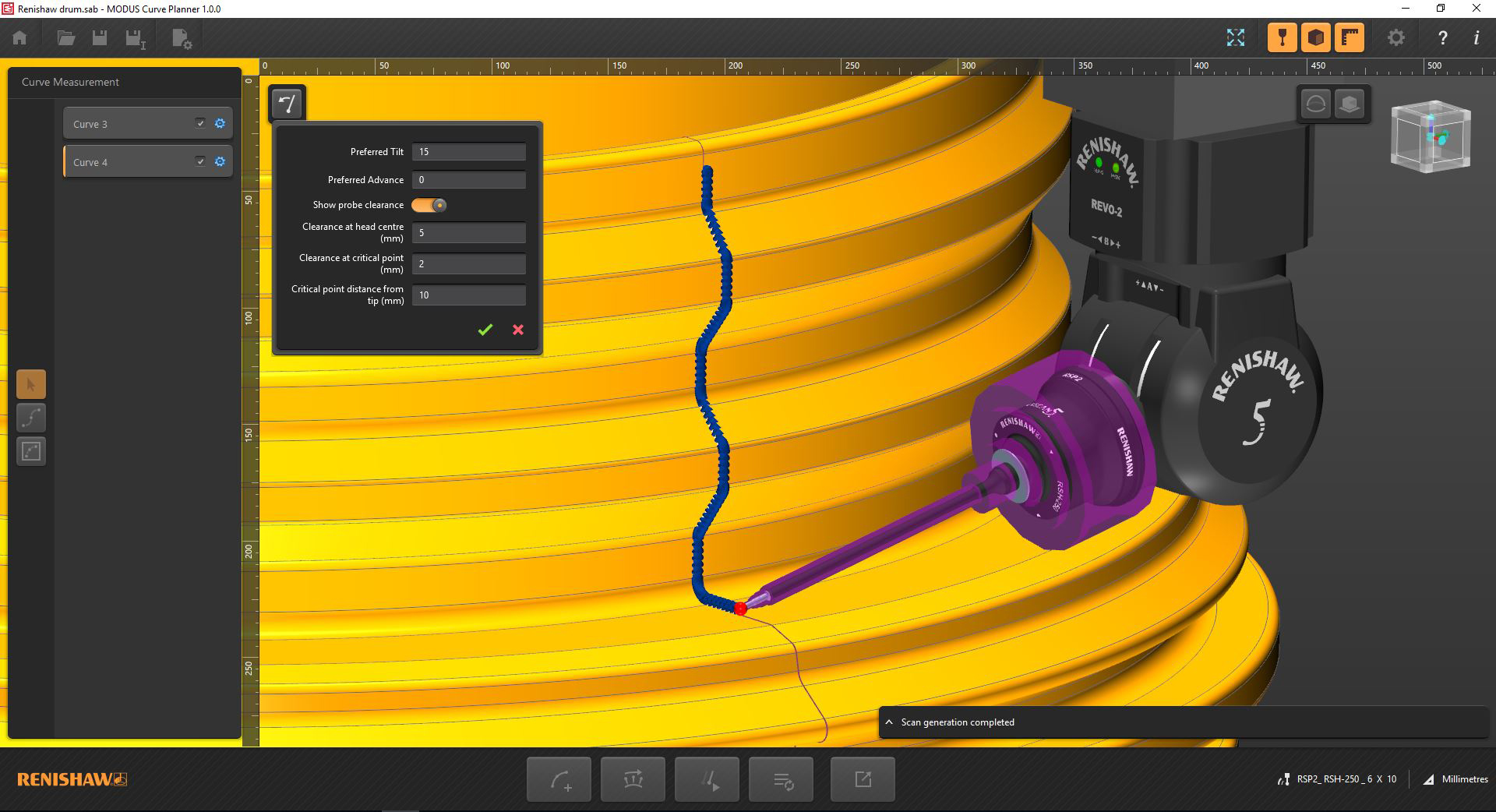

MODUS 1.13 software offers multiple enhancements in flexibility and usability for REVO sensors. Users can benefit from powerful new features within its specialist programming (MODUS Planning Suite) and reporting (MODUS CHART) tools.

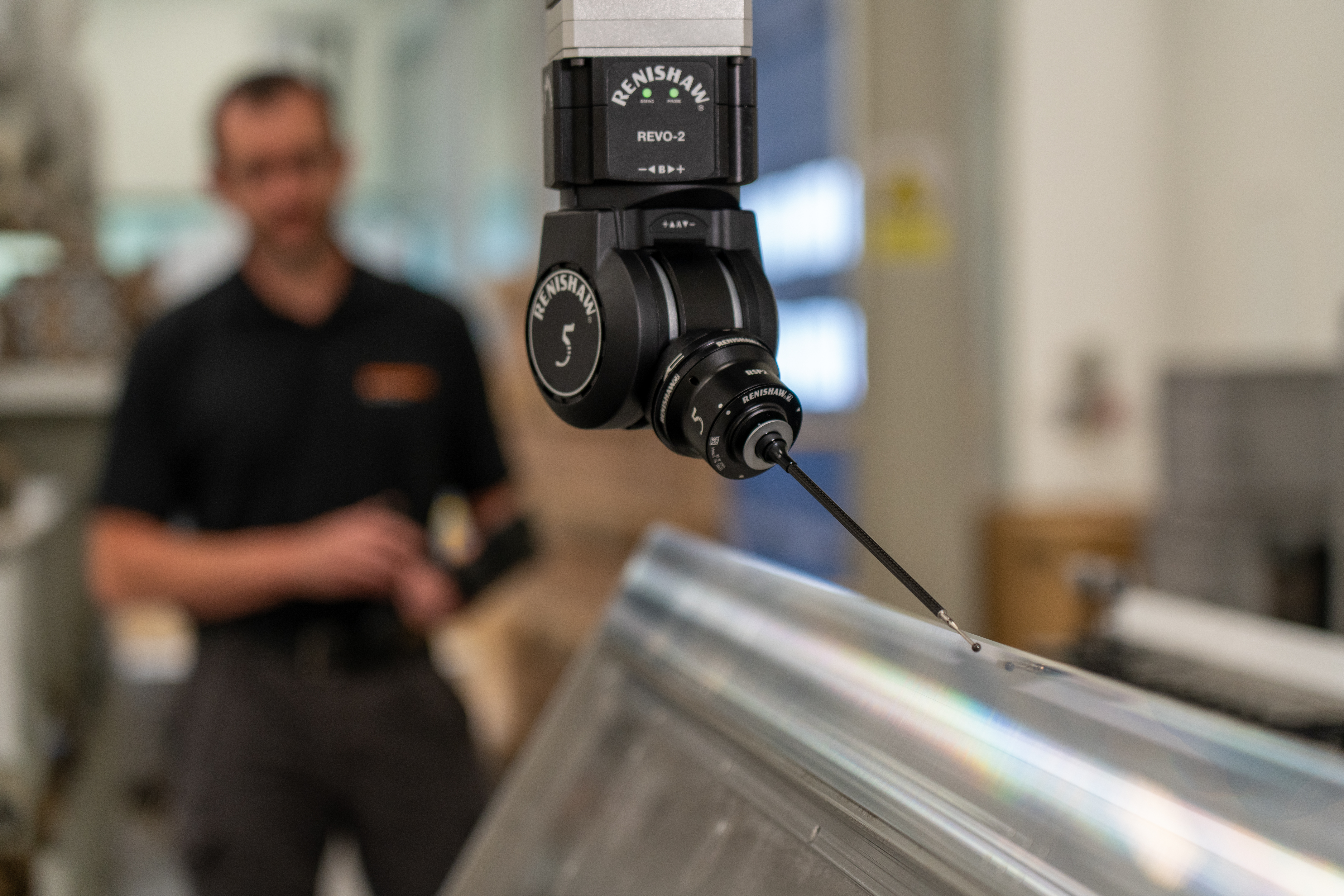

REVO-2 probe in action at Renishaw's Miskin facility

REVO-2 with RSP3-6 measuring engine block

Suite MODUS Planning - Esquisse de courbe [gen]
