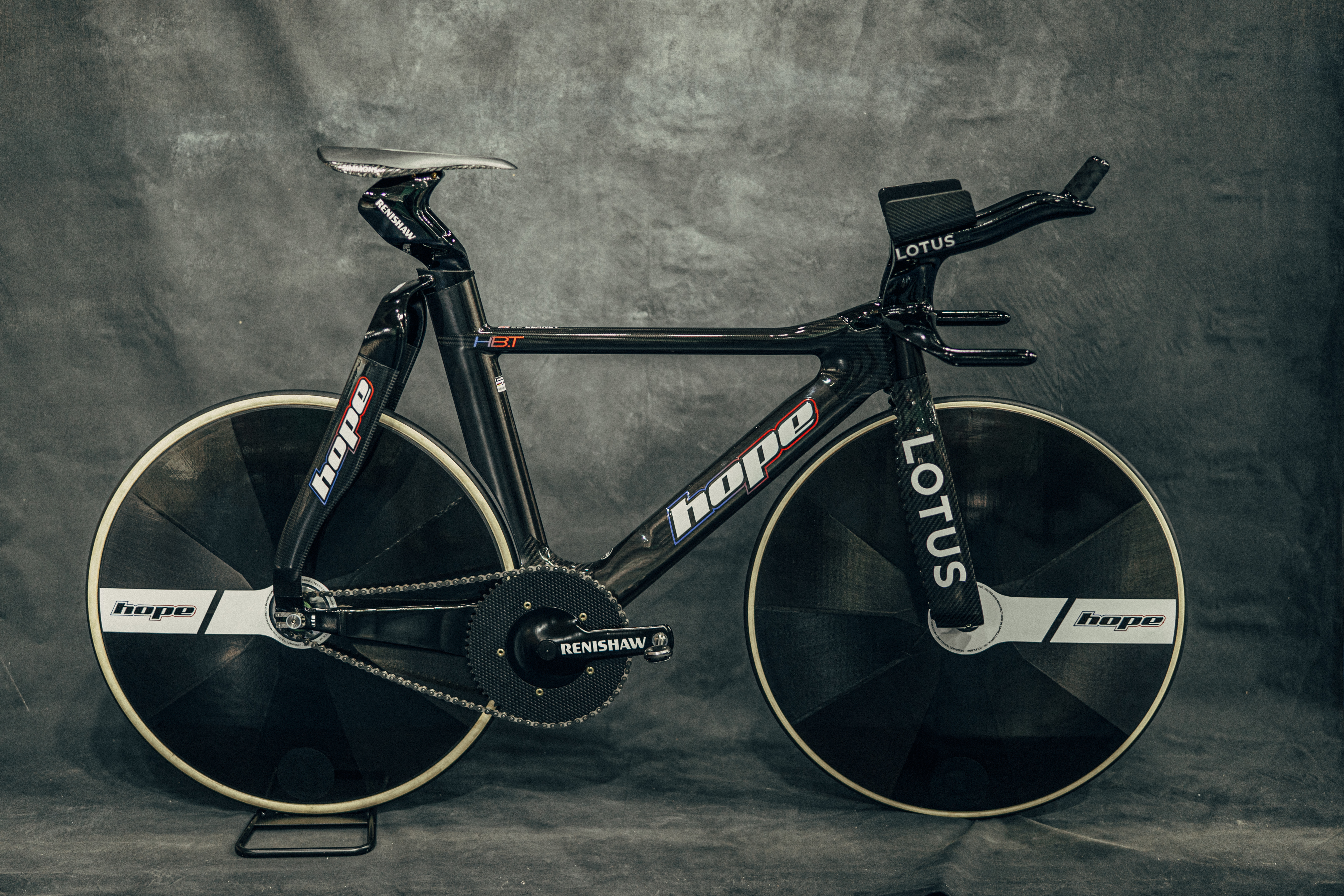

Renishaw has helped to design and manufacture a number of components on the bike, including the crank, seat stay bridge and dropouts, as well as a first-of-its-kind seat post created in aluminium. Using additive manufacturing (AM) to manufacture these parts allows the British Cycling team, alongside Renishaw, to change the design throughout the process and create complex and aerodynamic geometries that would not be possible using traditional manufacturing technologies.
Renishaw helped to design the internal structure of the titanium crank, to deliver an optimised lightweight part. By using an internal lattice structure that is not possible using other manufacturing methods, Renishaw has been able to maintain the strength of the part, whilst keeping it lightweight enough to accommodate the overall weight limits for the bike.

3D printed titanium crank on the British Cycling track bike
3D printed split seat post and seat bridge on the Hope Lotus track bike
