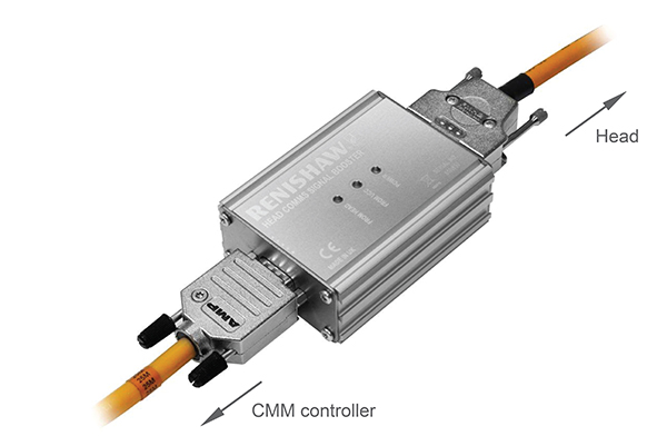

Head comms signal booster box installation
When using the Renishaw high-speed communications cable (orange cable) with Renishaw's 5-axis products, the maximum permissible cable length is 25 m. Where runs of greater than 25 m are needed between the machine controller and probe head, a head comms signal booster (HCSB) must be inserted. One HCSB is required for each additional 25 m of cable run.
The HCSB is powered from the machine cable so does not require an additional power supply. It simply connects between two machine cables as shown in the diagram below and can be attached to a suitable part of the machine structure if required.
Dimensions (L × W × H)
91 mm × 64 mm × 32 mm
Net weight
161 g
Power supply
20 Vdc supplied via machine cable
Connectors
15-way high-density 'D' type plug connects to cable from controller
15-way 'D' type socket connects to cable from head
Booster box with cable both ends - labelled

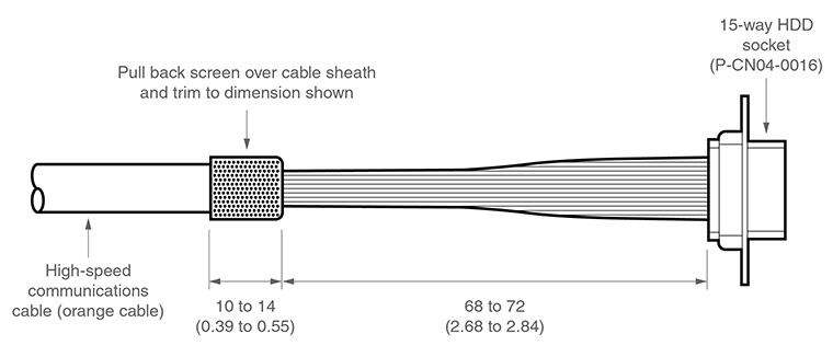

Preparation of Renishaw universal machine cable for quill mounted systems
Universal machine cable - quill mounted preparation

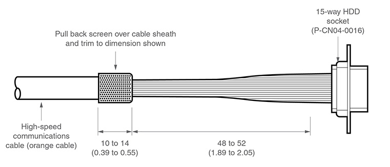

Preparation of Renishaw universal machine cable for shank mounted systems
Universal machine cable - shank mounted preparation
