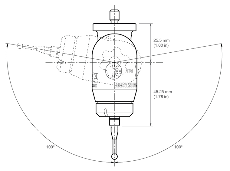

Dimensions
NOTE: Dimensions in mm (in).

Stylus overtravel (typical) | XY plane: ±22° +Z axis: 5.5 mm (0.22 in) @ 0.11 N 2 mm (0.08 in) @ 0.3 N |
