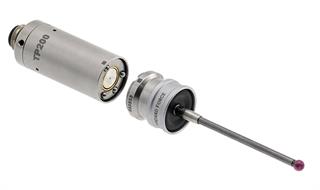

The TP200 / TP200B are electronic probes using strain gauge technology, which gives higher accuracy than kinematic touch-trigger probes. They combine outstanding metrology performance with superior functionality to produce a highly versatile DCC CMM probing system, with excellent productivity.
Features and benefits
- Excellent repeatability and precision 3D form measurement
- Rapid exchange between stylus configurations without the need to re-calibrate
- 6-way measuring capability (±X, ±Y, ±Z)
- Zero reseat errors and no lobing effect
- Suitable for intensive 'peck' or 'stitch' scanning
- Stylus reach up to 100 mm (3.99 in) GF range
- Module life of more than 10 million triggers
- Compatible with the full range of Renishaw probe heads and accessories
