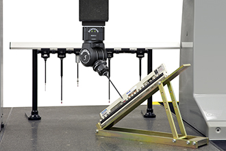

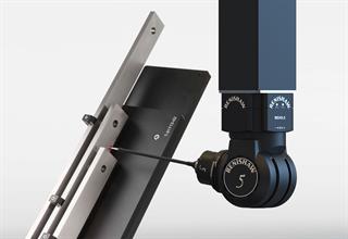

Renishaw has the ability to calibrate a CMM using different calibrated length artefacts including:
Gauge blocks | Step gauge |
Measurement uncertainty
For gauge blocks the accredited measurement uncertainty is ±(0.23 + 1.0 × L) µm (where L is in metres).
