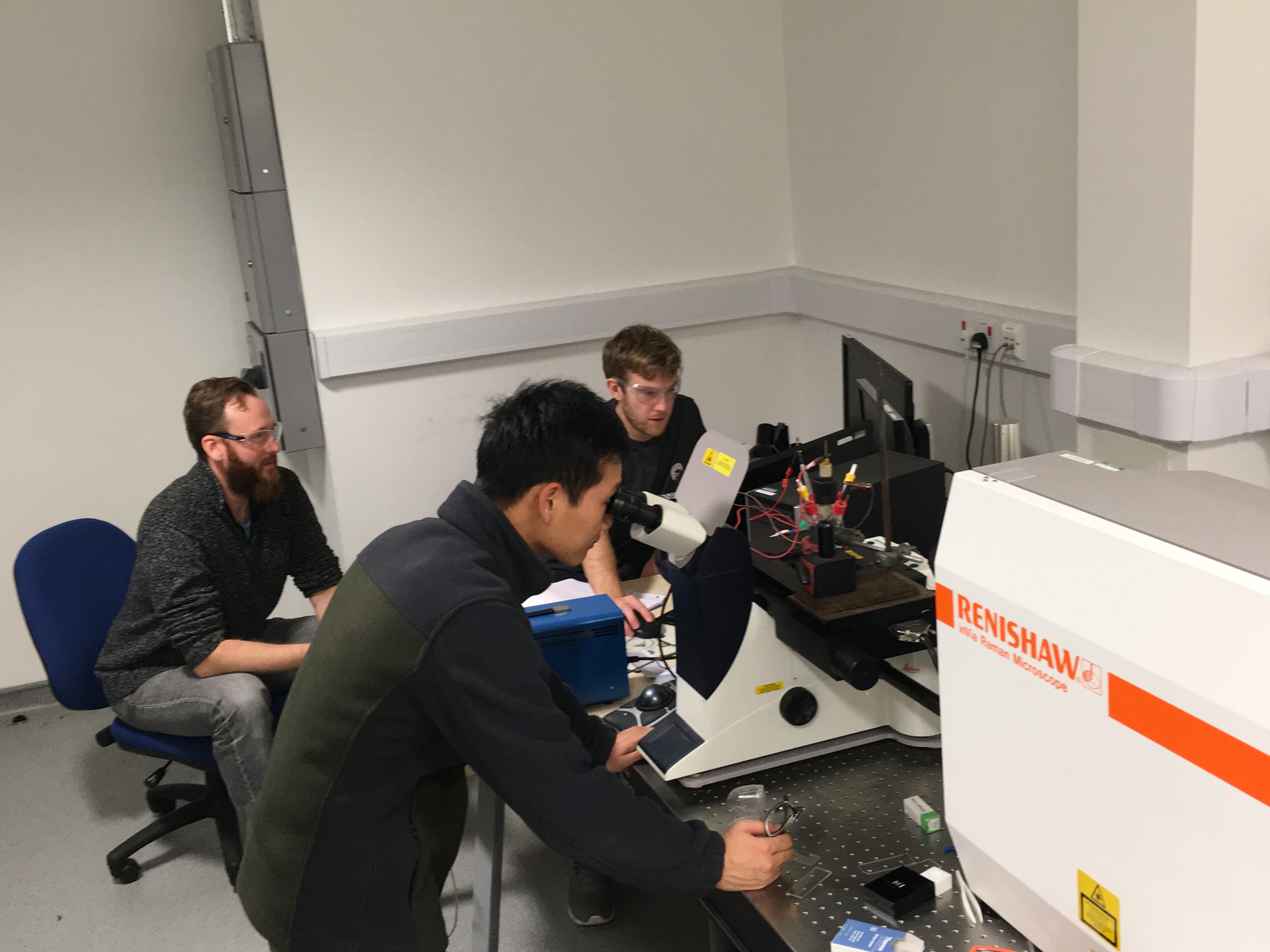

Hardwick Group in Raman Lab
Prof Laurence Hardwick and colleagues from The Stephenson Institute for Renewable Energy use their Renishaw inVia Raman microscope to perform operando electrochemical measurements.
