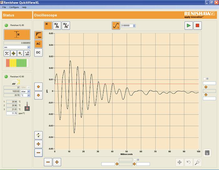

The simple graphical interface allows very flexible operation, avoiding the need for predefined measurement targets and sequences - just point and measure.
QuickViewXL™ provides the ideal tool for research and development and on the spot analysis as it enables quick and easy investigation, review and characterisation of motion systems such as travel linearity, acceleration times to travel velocity, over-travel and settle times at target positions, as well as resonance and damping.

  • Live data capture with 'oscilloscope' type display
  • Data capture rate of 50 kHz
  • Two modes of collating data, continuous "streaming" and triggered
  • Trigger mode allows snap shots of data events to be captured and analysed
  • Data is easily exportable in CSV (exportable to spreadsheet and Mathcad) format for offline analysis
  • Easy to use frequency measurement facility
  • Linear, angular or straightness measurement options
  • Select from distance, velocity and acceleration displays
  • Pan and zoom function enables detailed analysis of re-occurring error sources
  • Using an RSU10 USB interface allows for measurement data to be compatible with LaserXL and QuickViewXL software packages. This provides the ideal solution for users who need to view and analyse real-time dynamic measurement data.
Using an icon based interface, (almost no text) with a single screen for set-up, system status and data view, the 'oscilloscope' function gives a very graphic display of the captured (or 'streaming') data. A separate 'always-on' status bar gives an 'at a glance' view of XL-80, environmental and measurement status and warnings.
