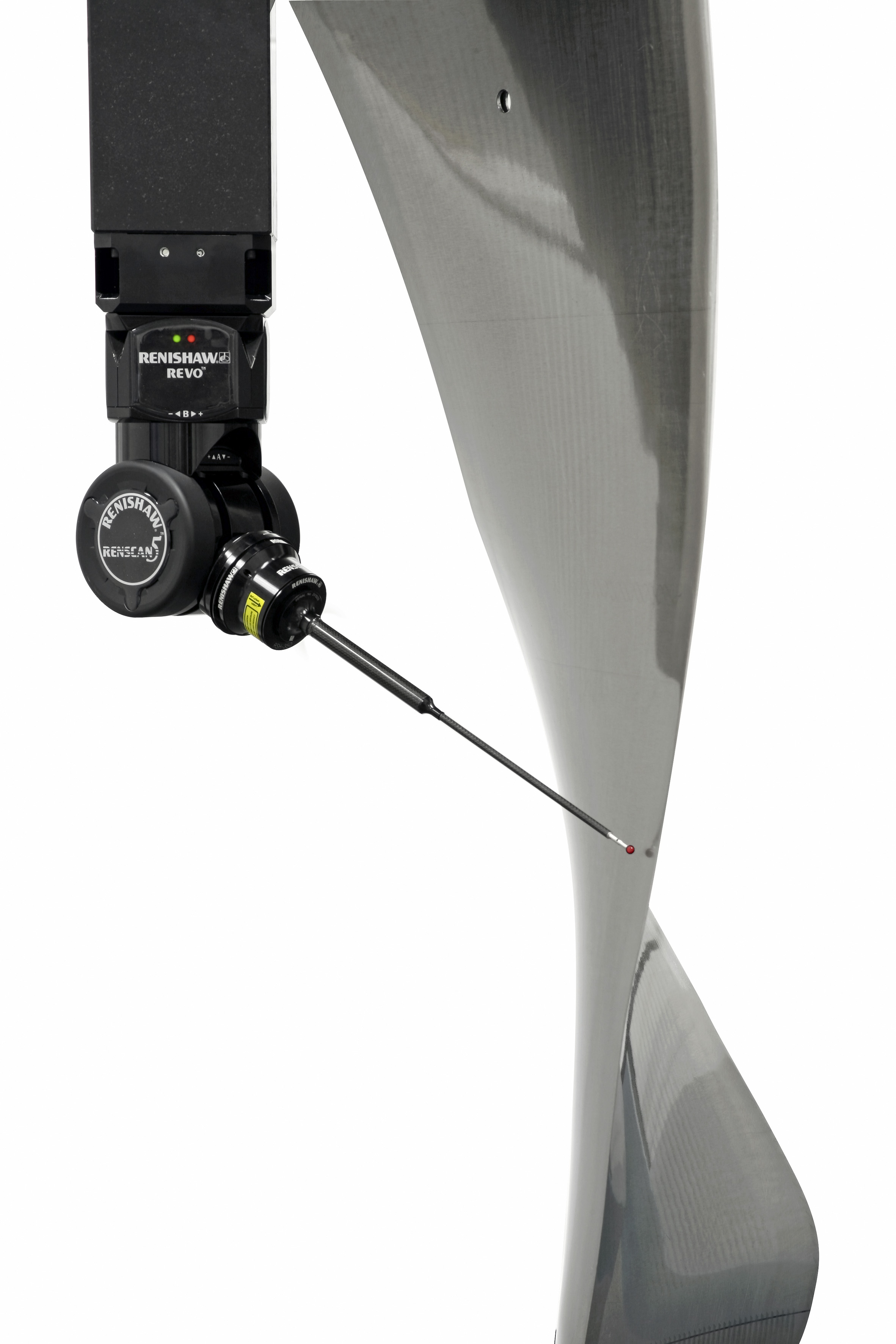

The first application was the measurement of an aero-engine blisk, requiring nine sectional scans of the airfoil profile, eight longitudinal scans on the blade, two scans of the root profile and finally, one scan on the annulus profile. Originally performed with a three-axis scanning system, the measurement of one blade took 46 minutes, compared to just 4 minutes and 30 seconds with the REVO® system, an exceptional 922% improvement in throughput.

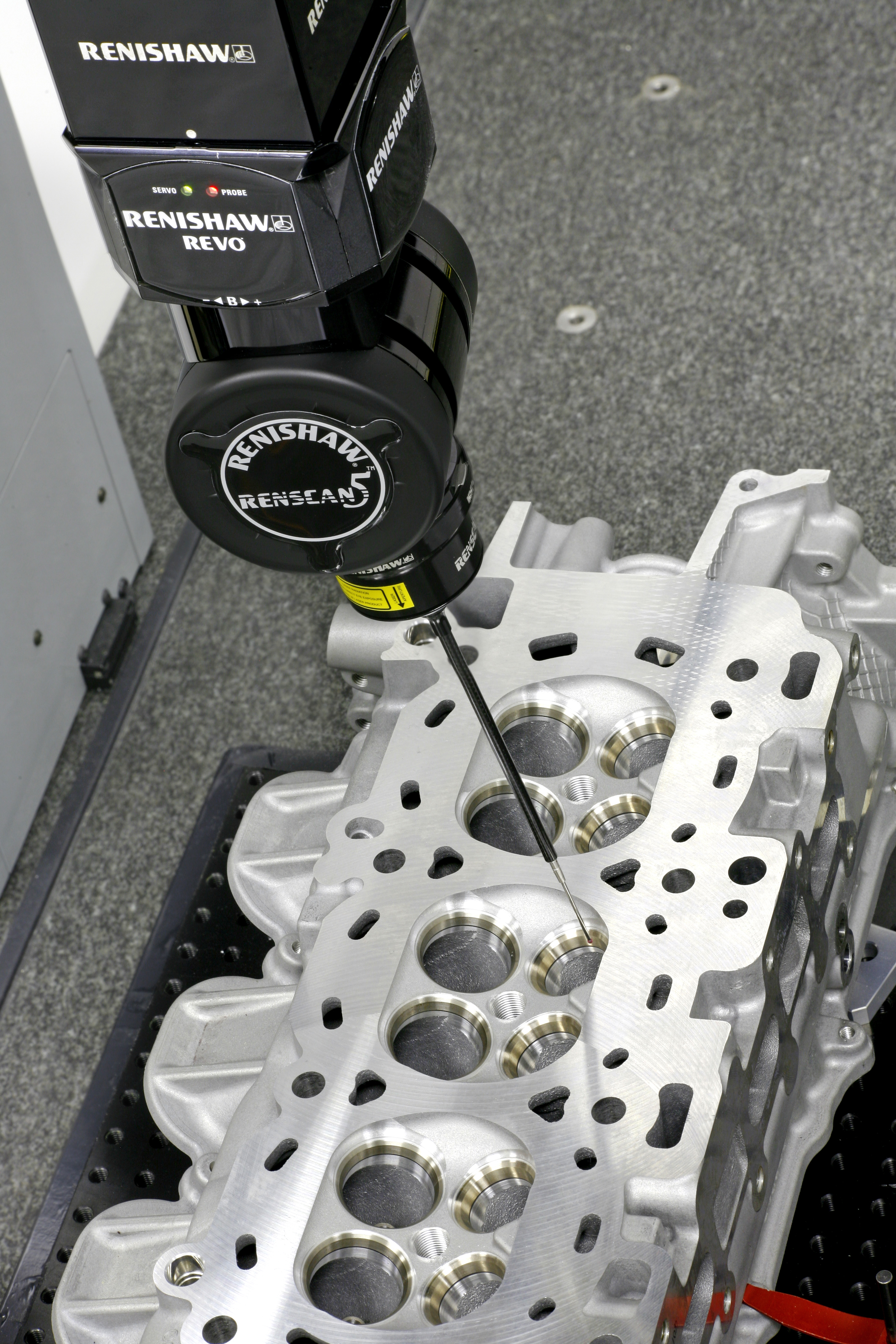

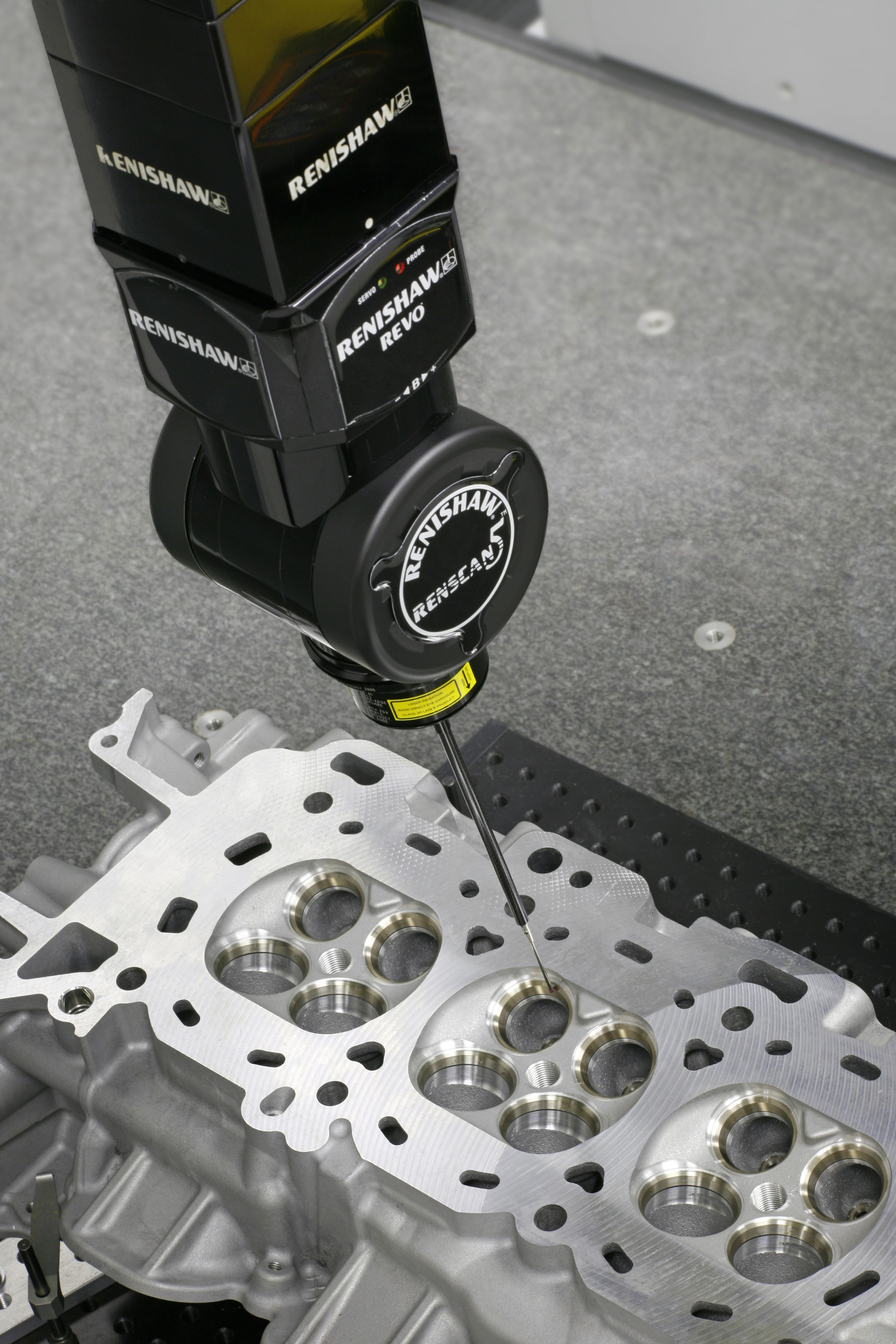

Renscan5™ REVO® measuring cylinder headAlmost as dramatic were the results obtained for an automotive cylinder head application which comprised the inspection of twelve valve seats, plus three circular scans on each of the twelve guide bores. With REVO® scanning the valve seats at 400 mm/second and 50 mm/second on the valve guides, the total measurement time was just 3 minutes and 42 seconds. This compared to the original time of 29 minutes and 13 seconds for the three-axis system, giving the manufacturer a 690% improvement in throughput.
